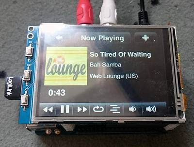

  • touch display (3,2" with 320x240 px) with calibration
  • visualisation of squeezebox features (latest jivelite with skin addon for 320x240 display)
  • optional Squeezebox Server with Shairtunes2 addon for Airplay
  • Squeezelite as software player
  • Kodi as video player
  • lots of other applications, installable by web interface (Accesspoint, Samba Shares, WiFi, etc.)

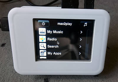

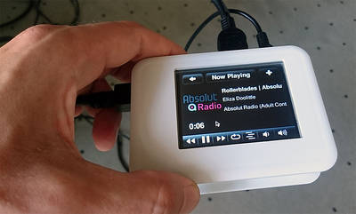

First setup: Raspberry PI with touch display
This one is the easy, good value for money setup, that has just one downside when using the headphone jack for audio, as it has not the best build-in DAC. The case looks quite nice and we already have a prebuild SD-Card-Image that just needs to be plugged in your Raspberry PI 2. If you are interested in a bundle that also offers powersupply and SD-card with Image you should have a look at our shop: http://shop.max2play.com/en/raspberr...e-display.html
If you like to build this on your own, you should grab yourself a 3.2" touch display and use the latest Max2Play-version to install Jivelite, visualisation skins and the Display itsself. I will link the addon for installer of the Raspberry PI Display on the addons page of Max2Play.

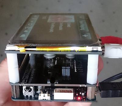

Second Setup: new ODROID C1+ with HiFi-Shield and touch display (not having a case yet)
This one has a little more power compared to the Raspberry PI, as the C1+ offers USB 3.0 and the EMMC-Cards are a lot faster compared to the class 10 SD-Cards in the Raspberry. This is mostly recognizable when you are running the Squeezebox Server on this device.
The HiFi-Shield (high quality audio with 192Khz) and the touch display work very well together and really offer the best Squeezebox Touch experience.
The downside is the price - compared to the Raspberry PI this setup already has a external DAC that is not too cheap (same price as C1+ board) and it also needs a case with an increased height due to that DAC.
